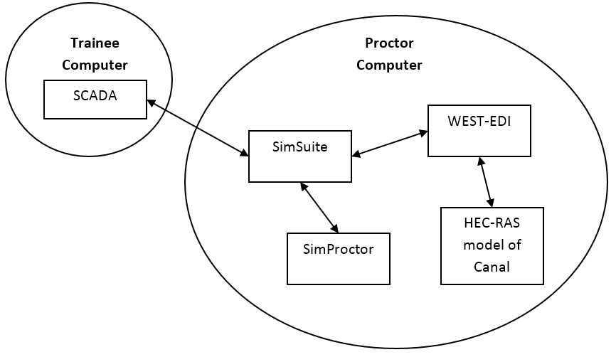

This question covers many topics from modeling irrigation canals using HEC-RAS to designing automatic controllers for irrigation canals.  It also references a project we completed several years ago where we linked an unsteady HEC-RAS model of the Central Arizona Project (CAP) Canal to a Supervisory Control and Data Acquisition (SCADA) program so that the operators of the CAP Canal could be trained using a hydraulic model rather than by operating the real canal.  CAP has an extensive SCADA system that allows them to monitor and control the entire 336-mile canal from their central control room.
This is similar to the concept of how pilots are trained using a flight simulator instead of flying a real plane.  In a way, we created a “flight simulator” for canal operators.  To make this project successful, we had utilized many of the HECRASController routines and had to create a program that linked HEC-RAS to the SCADA system.  We called this program the External Data Interface (EDI).  We are also pleased that the question references the newly published ASCE Manual of Practice (MOP)131 Canal Automation for Irrigation Systems. This new publication is intended to be an update on recent advances in canal automation.  On a side note, I was one of the editors for MOP 131, so thanks for the plug on the book!

The EDI program that the reader refers to did work successfully. We were able to model the unsteady hydraulics of the CAP Canal successfully and had calibration data to verify the model performance. In this particular project, we did not actually design feedback controllers or test the controllers via hydraulic simulation as that was not the goal of the project. Instead, we used the EDI as an interface between the HEC-RAS model of the canal and the SCADA system used to manually monitor and control the canal (manual-centralized control). As mentioned earlier, the EDI program was crucial in making the canal operator “flight simulator” work. A schematic diagram of how the “flight simulator” for irrigation canals is set up and how the EDI program fits into this scheme is shown below. Note that the SimSuite program in the figure is a program that emulated field hardware and maintained physical information such as gate positions, water levels, and turnout flows.  SimProctor is a program used to assist in the training of the canal operators.

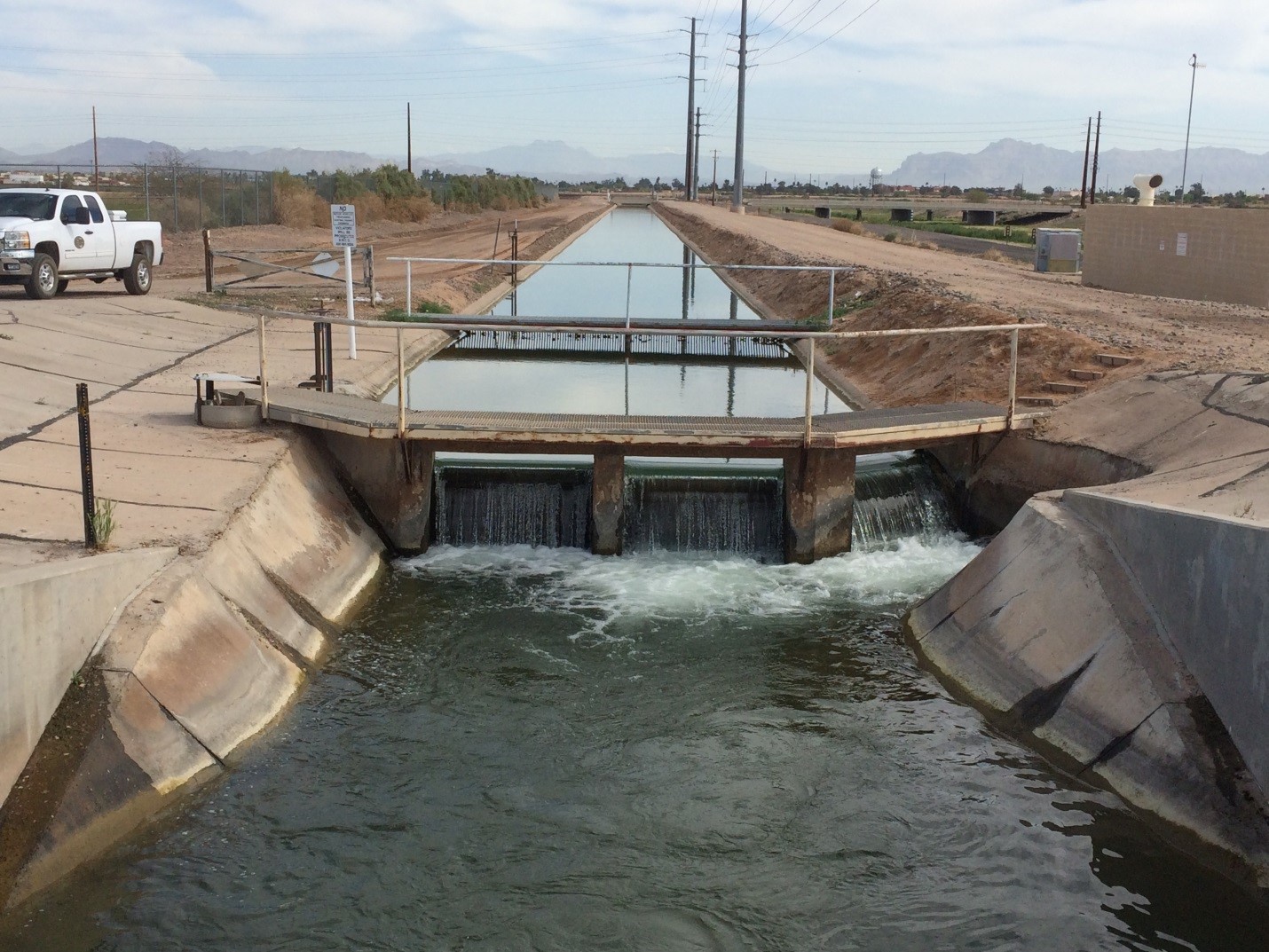

Yes, you can use HEC-RAS to model an earthen canal.  Sediment and weeds can influence the Manning’s roughness coefficients.  Thus, the canal may respond differently over time due to weed growth and sediment, so this is something that you should consider. The figure below shows weeds growing along the banks of an earthen irrigation canal as well as along the bottom of the canal. These weeds were seasonal and only appeared in the summer months.  Another issue would be canal seepage in earthen canals.  If you performed a seepage test on a canal pool, you could get an estimate of the rate of water loss from the pool.  You could then model this seepage from the canal using unsteady outflow hydrographs or possibly the groundwater interflow internal boundary condition.  Without performing a seepage test, you would really need very good (and detailed) calibration data to determine the seepage losses.
