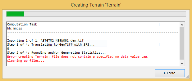

hello to everyone ,I am a relatively new user of HEC-RAS 5.0.0 and I hope you can help me with the following problem.
I want to create a new terrain importing a tif file in RAS Mapper.
During step 2 of 4: Rounding and/or Generating Statistics…, the following error message occurs:
„Error creating Terrain: file does not contain a specified no data value tag.
cleaning files

September 1, 2016 at 7:53 pm #10058AnonymousGuestIn arc export your Tiff with a no data value of -999 (or your favorite na value). Should work.
If you use Program R you can use this script too
setwd(“my_path”)
r<-raster("DEM.tif") writeRaster(r, filename="DEM_NA.tif", format="GTiff", NAflag=-999, overwrite=TRUE)September 2, 2016 at 6:53 pm #10059evuj31Participantthanks i will try this
September 2, 2016 at 7:31 pm #10060evuj31Participantthanks to everyone i found the solution :it’s to use fill in arcmap found in spatial analyst and then export the filled file
September 3, 2016 at 1:25 am #10061AnonymousGuestIt’s worth noting this ‘filled file’ likely contains a terrain model that was filled in order to remove sinks. If so, this is a rough hydro-correction to generate a terrain model that allows water to flow downhill to an outlet. And the terrain raster at structure crossings ought to be scrutinized, particularly at culvert crossings.

February 20, 2018 at 3:49 am #10066AnonymousGuestHello, Im using Qgis to generate de raster (geotiff). But I get the same error message (Error creating Terrain: File does not contain a specified no data value tag), when I try to create the terrain. Any ideas?? thanks!
March 11, 2018 at 4:03 pm #10067AnonymousGuestIf using QGIS then in the Translate (Convert format) dialog box you need to select the ‘no data’ option and assign a value, eg -999, before clicking OK to process conversion.
