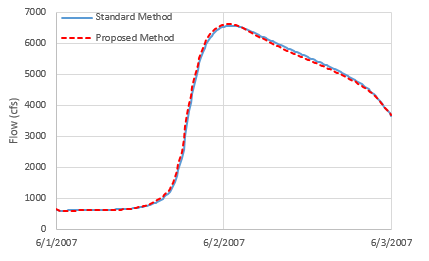

Hydrograph flow comparisons were also performed at several locations along the H100-00-00 channel reach. The comparisons show no significant differences in the two model approaches through the entire run simulation. The comparison hydrographs are presented in Figures 10 and 11.
Figure 10 – Flow hydrographs at River Station 57340.2 downstream of H119-00-00
Figure 11 – Flow hydrographs at River Station 7685.5 near downstream boundary of Hunting Bayou
