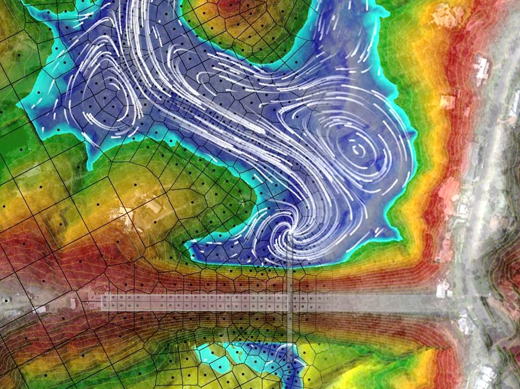

The tool may have initially been intended for the interpolation of bathymetric cross sections, but as long as your feature can be represented with cross-sectional data, the answer is yes! This dam, for example, was constructed using a 1D HEC-RAS geometry, which was then exported as a geotif:

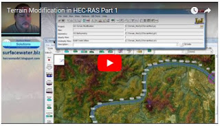

Here are the basic steps for modifying terrain in HEC-RAS, with RAS Mapper steps shown in red and Geometry Editor/Plan steps shown in blue: [Scroll down to the links below if you’d prefer to follow along with a video rather than following written instructions.]
With those steps complete, you can compare the results with and without the changes. If you are working on an impact assessment, for example, you can then make further adjustments to your mitigating features (such as the size of a detention basin) to compensate for the impacts of development as required.
In the steps above, we could have exported a geotif for the entire cross section extent (in which case you wouldn’t need to create bank lines) but my preference is to use the “channel only” option with bank lines as it gives you more control over what portion of the terrain will get adjusted between cross sections.
Also keep in mind that the 1D terrain modification geometry can be a complete, “runnable” 1D geometry, or it can exist solely for refinement of the digital elevation model (as highlighted below, it can essentially be an orphan file that is not associated with any flow or plan files).
Following are some instructional videos that step you through the process of modifying terrain in HEC-RAS:
