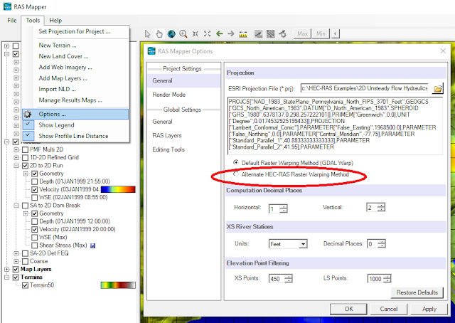

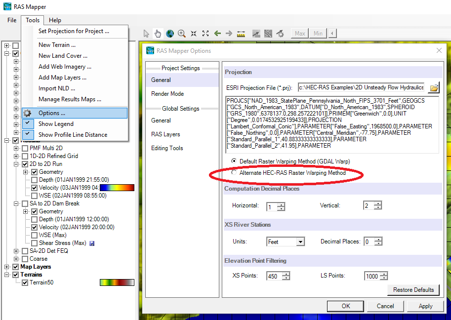

If you have confirmed that the correct projection file is being used and you are still having issues, there are a few additional workarounds you may wish to try. One option is to select the “Alternate HEC-RAS Raster Warping Method” under “Tools | Options” in RAS Mapper. This method applies the gDAL OGR vector reprojection. I have found this method useful for resolving discrepancies in European data sets in particular.
In some cases, the alternate method doesn’t do the trick either. RAS Mapper uses the ESRI projection file format, which as I understand it does not recognize TOWGS84 parameters and in some cases improperly applies the proj.4 projection parameters. In any case, you may find yourself stuck with misaligned web imagery.
