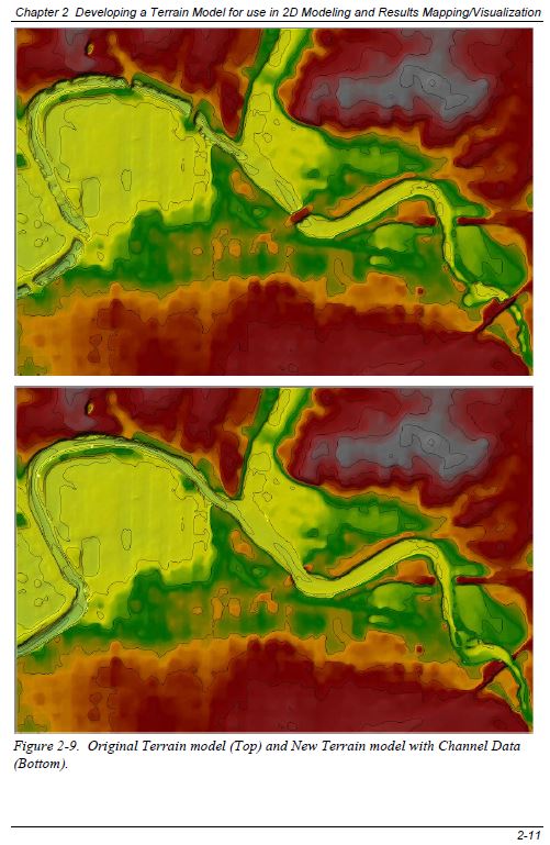

Here’s a screen shot of Page 2-11 in the HEC-RAS 2D User Manual showing a bridge deck included in the terrain data and then removed from the terrain data. Now you see it, now you don’t:

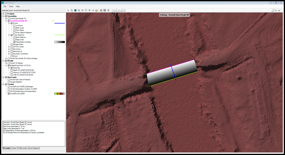

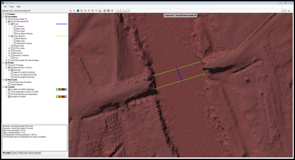

The following images are courtesy of Cameron Paintin from Riley Consultants, who applied these steps for a project in New Zealand.

In this screen shot, Cameron has drawn a river reach with cross sections on either side of the bridge:
This process can be repeated with additional reaches for any other bridges in your terrain. The following screen shot shows the interpolation surface created by the bounding cross sections:
And the final image shows interpolation surface on top of the terrain to blend out the bridge:
