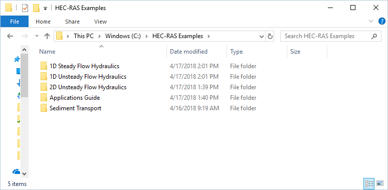

3.    Example Projects and Applications Guide.  When you download HEC-RAS, you not only get the software, but you get all of the manuals listed above, plus some other useful documentation.  You also have the option to download a larger install package that contains the Example Data Sets.  DO THIS!!!  These example data sets are invaluable.  As you can see in the figure below, the example projects are organized into 5 folders after you download them and unzip them to your computer.  Notice the fourth folder called “Applications Guide”.  These are all of the HEC-RAS projects documented in the Applications Guide manual.  If you want to do some self-training, there is no better way than to go through each of these Application Guide Examples one by one.  In fact, I highly recommend going through at least a handful of them before taking a training course.
The Applications Guide is designed to provide example projects for you to work through alongside instructions for a wide variety of HEC-RAS applications.  In fact, the manual has examples that cover just about every kind of geometric element you may want to use, including bridges, culverts, dams, lateral structures, storage areas, junctions, etc.  Unfortunately, the current Applications Guide does not have any 2D examples, but there are 2D examples in the HEC-RAS Example Data Sets.
