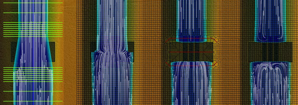

Here’s the schematic plan view for four culvert methods available in Version 5.0.4, with the new “coordivert” in our demonstration model shown in the canal on the far right:
A description of each method is included here. (A fifth method, entering the bridge piers or culvert walls as 2D terrain only, wasn’t included here since it is only appropriate for open channel flow.)

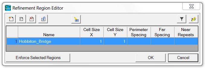

To take advantage of the new capability to define a finer mesh within a polygon, we’ll use a “Refinement Region” in RAS Mapper. After delineating a polygon under the refinement regions layer, the next step is to right-click on the shape and select “Edit Refinement Region Properties” and enter a cell spacing (in this case 1 meter by 1 meter):
With the higher resolution area defined, if you zoom in on the refinement region, you’ll see a more detailed computational mesh inside the 2D Flow Area:
In this case, I’ve defined a tighter mesh spacing around the roadway and culvert and left a lower-resolution mesh in the open channel areas. This feature can save a substantial amount of computation time and prevents the need to create multiple 2D areas to reflect varying resolution requirements – or the menial task of creating an excessive number of snaking breaklines with red-dot errors that need fixing!

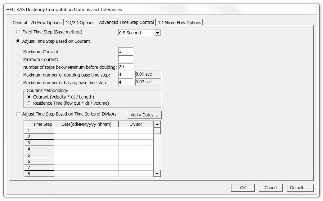

The window with the new option to use the Courant Number criterion is shown below. With the adjusted time step selected, the model will increase or decrease the computational time step automatically based on the computed velocity. This can give you significant speed improvements if you were already conservative with your time step. If you had an unstable model, however, the use of this feature will slow it down as it slices the time step to stabilize it. In this case, our 0.5-second time step can be doubled four times or halved four times, giving it a potential range from 0.03 to 8 seconds:

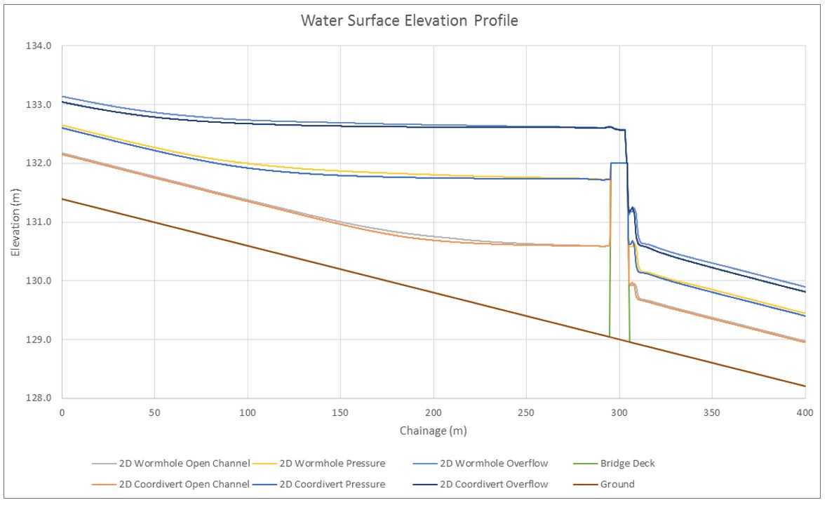

Here are the water surface profiles comparing the coordi-culvert to the wormhole culvert for open channel flow, pressure flow, and overtopping flow conditions:
As you can see, in the vicinity of the culvert, the results are effectively identical for all three flow conditions, which brings us to the bottom line: the wormhole has closed with the release of Version 5.0.4, and wormhole culverts have officially been retired – not just for long culverts, but for internal boundary conditions as well. Mega-cell culverts have also become obsolete now. From what we’ve seen so far, the new culverts provide equivalent results with much more functionality – particularly the fact that they work perfectly fine with the roadway/bridge deck represented as terrain or removed from the terrain and replaced with a weir embankment – so good riddance to both the worms and the Cells Of Unusual Size!

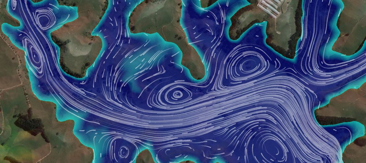

And finally just for fun, let’s ramp up the flow and see if an Orc-dam can flood out Hobbiton; if you want to see how the Hobbits fare in the flood, further details, animations, and comparisons of the new features are available here, or feel free to follow along with the instructional videos covering each of these new features separately.
In this case, our particle tracing shows that this one may catch Frodo in a whirlpool – and suck him right through the Orc-pipe that we can now move anywhere in our model thanks to the new coordiverts in Version 5.0.4!
