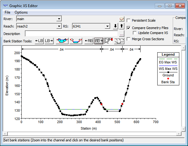

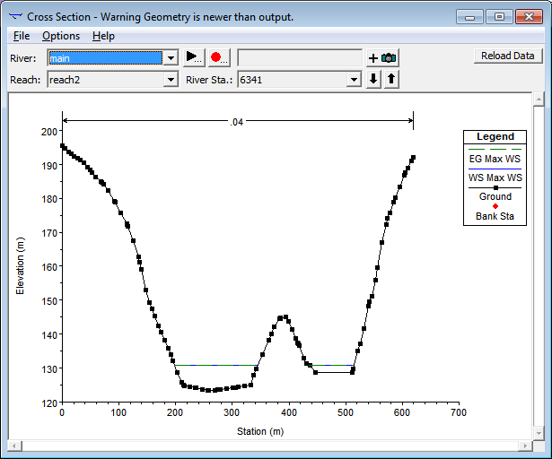

Sometimes locating the bank stations are not as obvious as these examples.  For example, where should the bank stations be placed for a cross section like this?
One might initially conclude that the deeper channel should get the bank stations in which case you may place them like this:
However, it is important to know what is happening upstream and downstream of this location before you can make this decision.  Perhaps the smaller channel is actually the main conveyance and there just happens to be a large low-lying area in the left overbank.
You would only know this by studying the reach above and below this spot.  Having nice aerial imagery behind the geometry schematic can help to make this decision for you.
