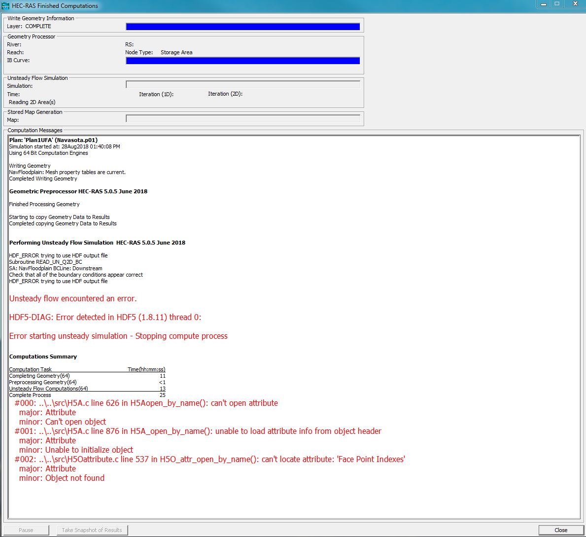

    New tothe site, and slightly less new to the program, first time having error messages after a couple successful 2D models. any chance someone can help me out or point me in the right direction? beofre i was having mesh issues but when i finally resolved that I still had this. I understand .hdf is a file and someone before recommended deleting it, but that didnt help.
    #8892
    I get this error when i have boundary conditions that do not match my unsteady flow editor, or vis versa. Many times, that error message means it not reading you flow or boundary conditions correctly
