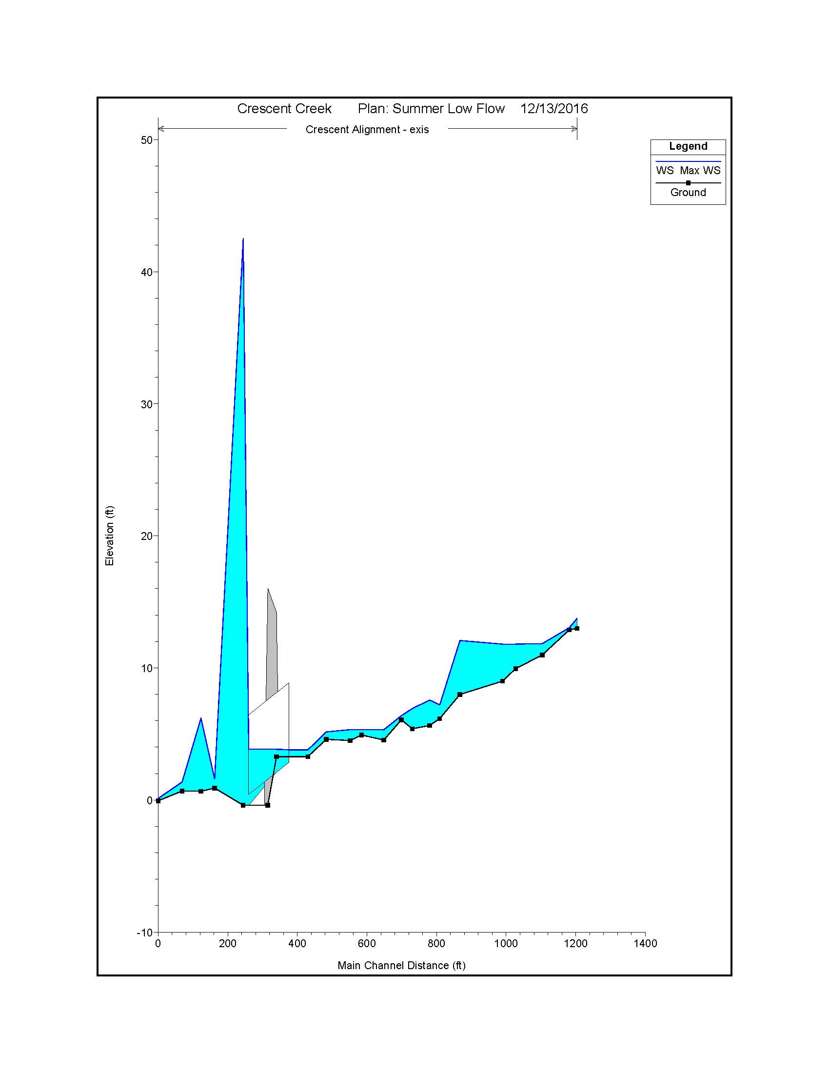

    I am using RAS to model a culvert (unsteady) and keep getting this error message. My steady flow runs work, so the culvert geometry is set OK.
    ***** Error! Extrapolated above/beyond Rating Curve (Bridge/Culvert/etc.) *****
    At River Crescent Reach Alignment – exis R.S. 385
    #10294
    cameron
    Unsteady is totally different than Steady modeling. Did you set the Htab parameters correctly, choose the correct computational interval, are the ineffectives correct for low flows? From the figure, it looks like the culvert length is far longer than the width of the road, is this correct?
