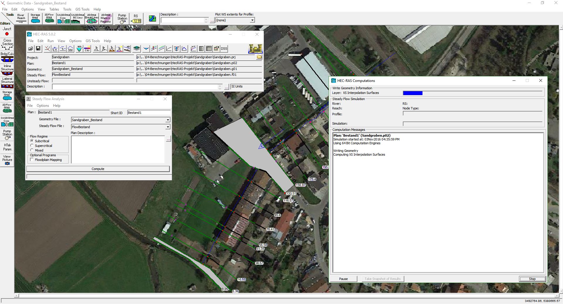

    Hey guys,
    I have built up my hecras model and changed the levees and ineffective flow areas. Then I wanted to calculate it. But the calculation stops after a few seconds in the calculation of XS Interpolation Surface (see Image). I don´t what to do now. Had anyone ever the same problem? I would be very thankful for help (Sorry for my bad english).

    Was it ever working? I have seen HEC-RAS have issues like this when some of the cross-sections are set up to close together and are different lengths or cross-sections are overlapping.

    Hello,
    thank you for answering! Yes, it was working. I have extended a cross-section to better represent the foreland. Then it was still running. After changing the levee in a cross-section the computation stops…
    The cross-sections are set at a distance of 20 m from each other and do not overlap. Now I have adjusted the length to minimize the difference….but it still stops…

    I would start doing tests by removing items until I found the issue. In your case, I would start with the levees by removing them all and adding them back in 1 at a time until the problem occurs.

    First I deleted the Levees. Computation stoped. Then I deleted the Ineffective Flow Areas. Computation still stoped. Then I upload the geometry via CSV and replaced the cross sections. Computation worked…
    Thank you for your help!
