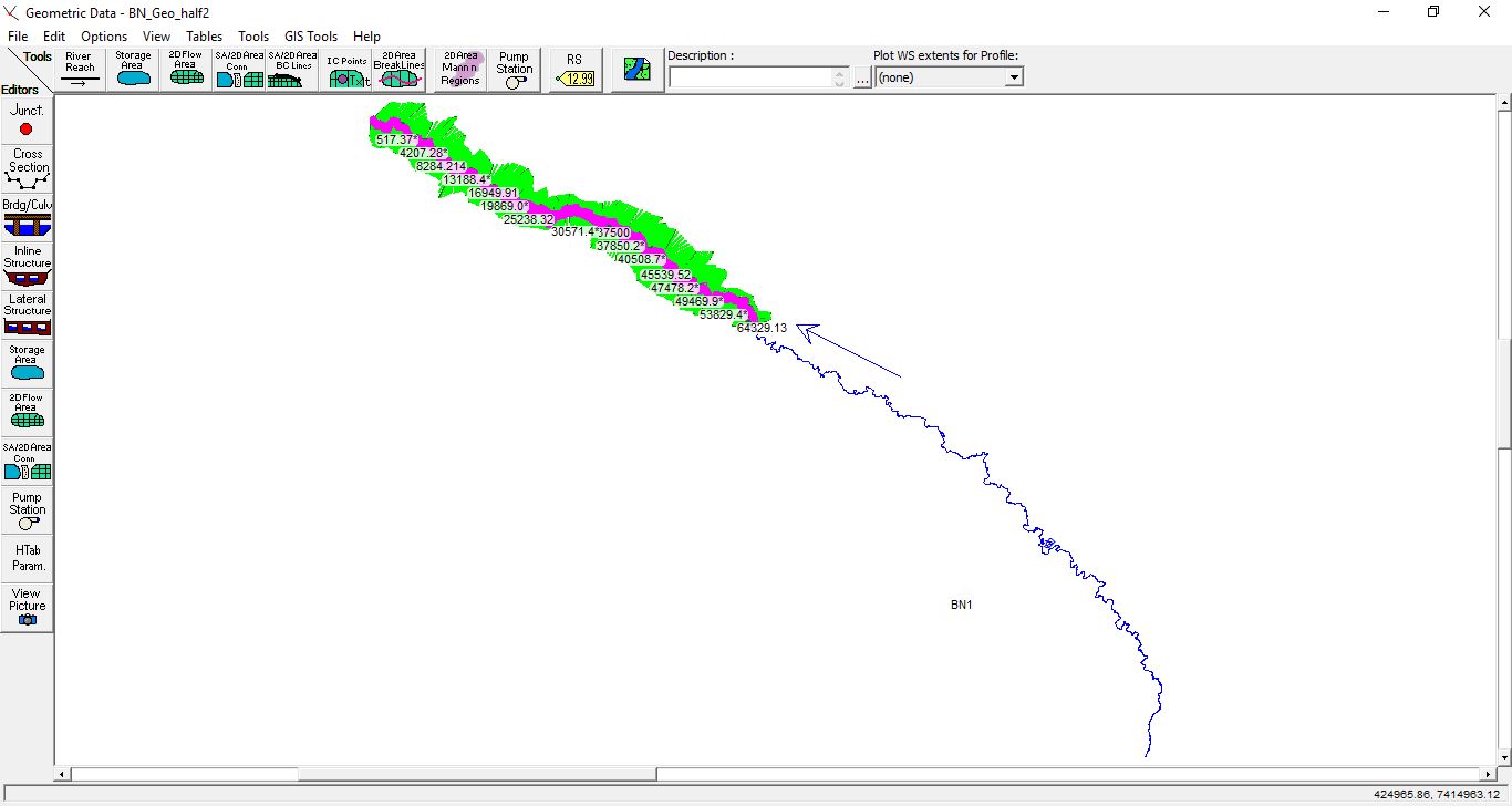

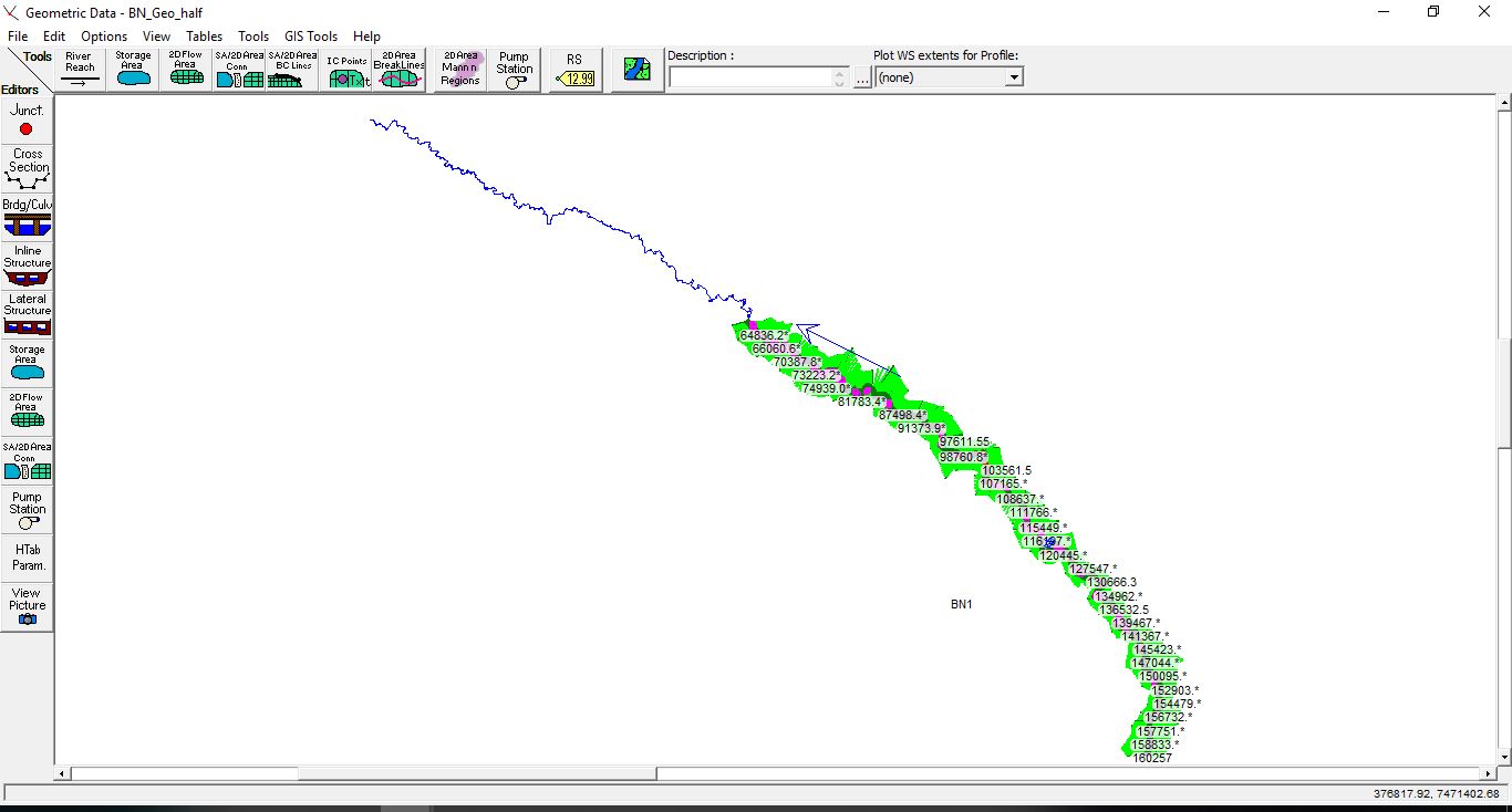

    I`m trying to simulate a river, but I would like your opinion… My model is unstable and, to get a better result, I thought about splitting one of my channels in two. That way, it was a lot easier to control the variables. The idea was to import the DSS data of the last dowstream element of the firs part as the start of my next simulation… The question is, what would be better: to use the stage or flow hydrograph as the boundary condition? They are resulting in differents solutions, specially in the XSs closer to breaking point….
    Here is how I broke the channel in two…
    Thank you all for your opinions!

    Thats absolutely ok to do! in many cases it is necessary to begin the stabilization of large river networks and i always recommend stabilizing 1 reach before moving to the next. Your downstream boundary condition is not as important to the stabilization as you may think when breaking up a multiple stream network. You can use normal depth or a known WSEL just make sure that your model does not go into critical depth within the last cross section.
    Then use the hydrograph output as the input at your US cross section in the connecting model.
