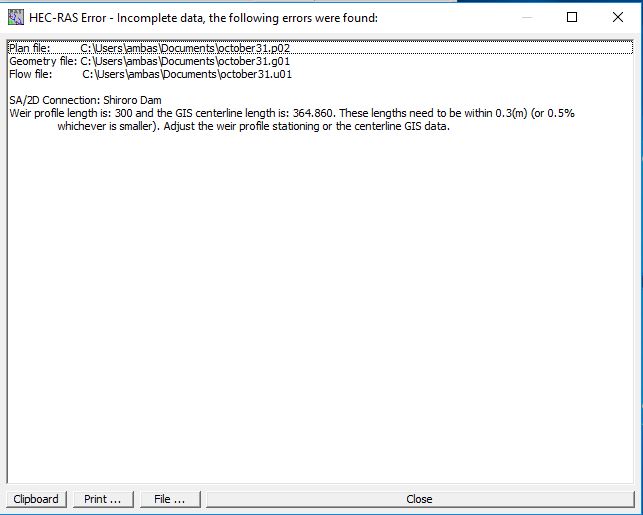

    i Am running an unsteady 2D model seperated by a weir as DAM (storage and flow area). i am getting the below message as error please help me on how to go about adjusting the weir profile stationing or the centerline GIS data.
    Thank you
    This is the exact error message:
    HEC-RAS Error – Incomplete data, the following errors were found:
    Plan file: C:\Users\ambas\Documents\october31.p02
    Geometry file: C:\Users\ambas\Documents\october31.g01
    Flow file: C:\Users\ambas\Documents\october31.u01
    SA/2D Connection: Shiroro Dam
    Weir profile length is: 300 and the GIS centerline length is: 364.860. These lengths need to be within 0.3(m) (or 0.5%
    whichever is smaller). Adjust the weir profile stationing or the centerline GIS data.

    you need to either change the stationing of the weir or update the GIS line of the weir to be basically the same.
    #12588
    engrambas
    Please can you put me through on how to move the stationing of the weir
    #12589
    go to where you enter the weir elevations for the weir and change the stationing to be the same as the length.
