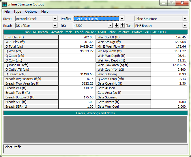

    HEC-RAS Inline Structure Output window shows Q Total, Q Weir, Q Breach and other flows. You would think that Q Total = Q Weir + Q Breach. However, this results window will always show Q Total = Q Weir. I looked unsuccessfully throughout the User’s Manual for answers.
    Any ideas or clues what these three flows represent?
