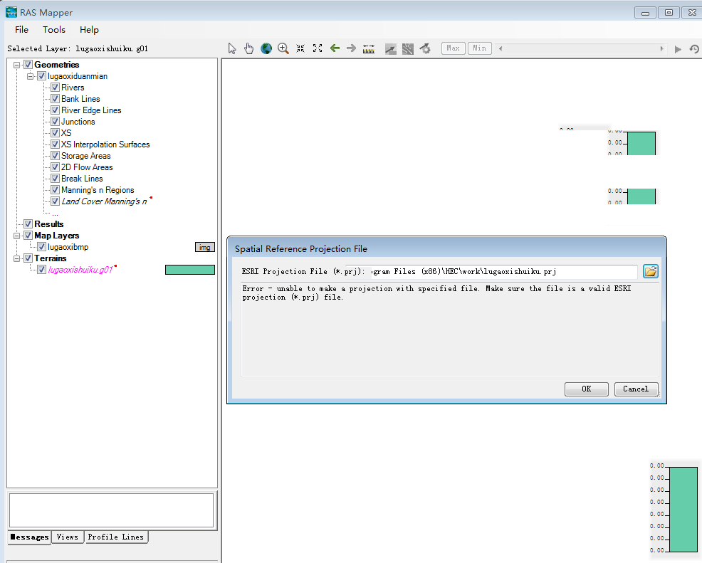

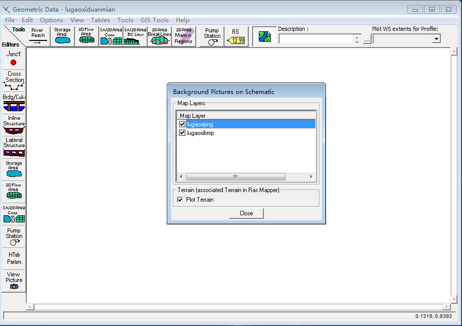

    The hecras 5.0.3 can not load a jpg file as a river reach background image! please help me to solve the problem
    Thanks a lot!
    #10705
    qiaochangkai
    I guess I have problem to make a projection with specified file. Make sure the file is a valid ESRI projection (*.prj) file.
    Actually, I need a background picture to draw a river reach, I don’t know how to find a ESRI stuff.
    #10706
    cameron
    The ESRI prj file is different than the HEC-RAS prj file. You need to determine which projection you are working in and create a prj file that represents that either in GIS or download from a website.
