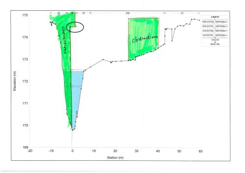

    Hi There,
    is there a way to put obstruction to a xs for non-straight vertical wall, as shown in the pic below for the left bank?
    Thanks in advance.
    Yuna
    #9447
    You could add a “lid” to the cross section. The lid could could jut to the side like that. In the area between the two obstructions make the bottom of the lid really high so it stays above the maximum water surface.
    #9448
    Yuna C
    Tried that and it seems working like what I expected so far. thanks 🙂
