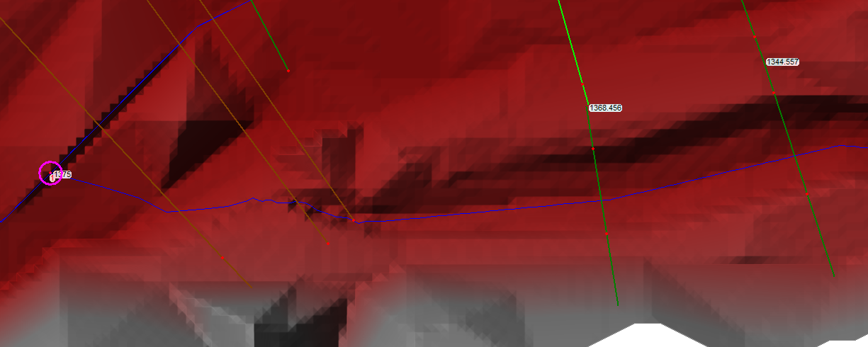

    I’ve added a new cross section to my geometry, and the line segment is not showing up (it should be between station 13+68.456 and Junction 1) – the only item that was added is the label (“1375”), which is placed at the junction rather than the correct station.
    Any ideas on this?

    It could a couple things.
    You stationing is not is not correct
    You are working with a interpolated cross section (just rename it without an asterik)
    The cross sections geo referencing has been thrown off and overriden in the GIS tools
