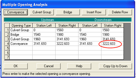

    Hi how do i resolve the following error? The occured when i tried to analyze the multiple opening culverts openinings:
    HEC-RAS Error – Incomplete data, the following errors were found:
    River: “BANKS” Reach: “STREAM” RS:100.1 MO
    – multiple opening stagnation limits on the upstream side do not cover the entire cross section.
    – multiple opening stagnation limits on the downstream side do not cover the entire cross section.
    #10028
    tzevoon
    Check the decimal points of your station.
    I have the same problem.
    In the Multiple Opening Analysis window, My last station (Station Right) was entered as 3222.60m and it gave me the same error message.
    The last station was actually 3222.603m and correcting to this value removes the error messgae
