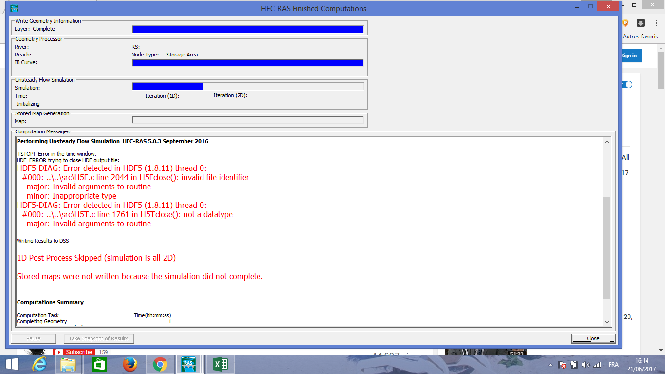

    Hello everyone,
    I am working on a 2D project with HEC RAS.After i did everything,i tried simulate my project.However,i received this error message down below.
    Please,does anyone know what does it mean?i am still new at this.
    Thank you for your help.

    RAS is not very “international”. Do you have your Windows operating system set to something besides “English”? If so, try setting the Windows operating system to English (American) and see if that fixes the problem.

    Houssem Hmaidi
    Thank you Jarvus for your idea but it didn’t work.what i don’t understand is that the project worked fine the first time but when i changed the flow data is started giving me that error message

    Houssem Hmaidi
    Hi again jarvus,
    I did what yoy told me again and it worked.Thank you so much for this.I really appreciate your help.
