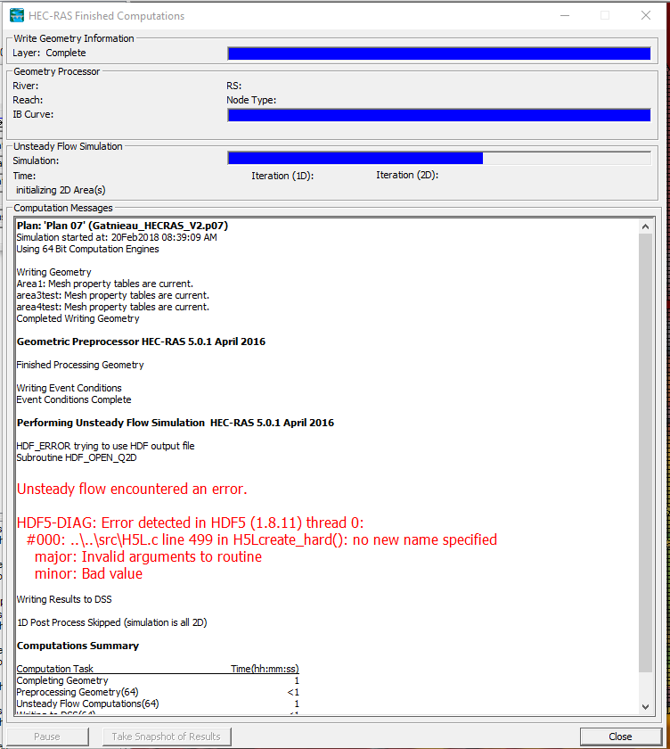

    When I try to run an unsteady flow simulation in a 2D model, I am getting an error message after the goemetric preprocessor finishes. I tried searching for this specific error message but I couldn’t find anything. I also double checked for language and date settings, everything is set correctly.
    Has anyone encountered this erro message in the past ?
    Performing Unsteady Flow Simulation HEC-RAS 5.0.1 April 2016
    HDF_ERROR trying to use HDF output file
    Subroutine HDF_OPEN_Q2D
    Unsteady flow encountered an error.
    HDF5-DIAG: Error detected in HDF5 (1.8.11) thread 0:
    #000: ..\..\src\H5L.c line 499 in H5Lcreate_hard(): no new name specified
    major: Invalid arguments to routine
    minor: Bad value

    go and delete the hdf file it is trying to create and then run it again.
    You could also try upgrading to 5.0.3
    #11189
    SimonD
    I tried both 5.03 ans 5.01 and I get the exact same error. I also tried to delete HDF files, closing and re-opening HEC-RAS but I get the same error message.
    I also tried to import the geometry file into a “clean” .prj file to make sure no intermediate files were in the way but I get the same error.
    Still no luck…
    #11190
    *UPDATE: RESOLVED*
    The issue was that a breakline in my model had a blank name, causing the simulation to stop right after the geometric preprocessor.
    Deleting and redrawing said breakline solved the issue.
