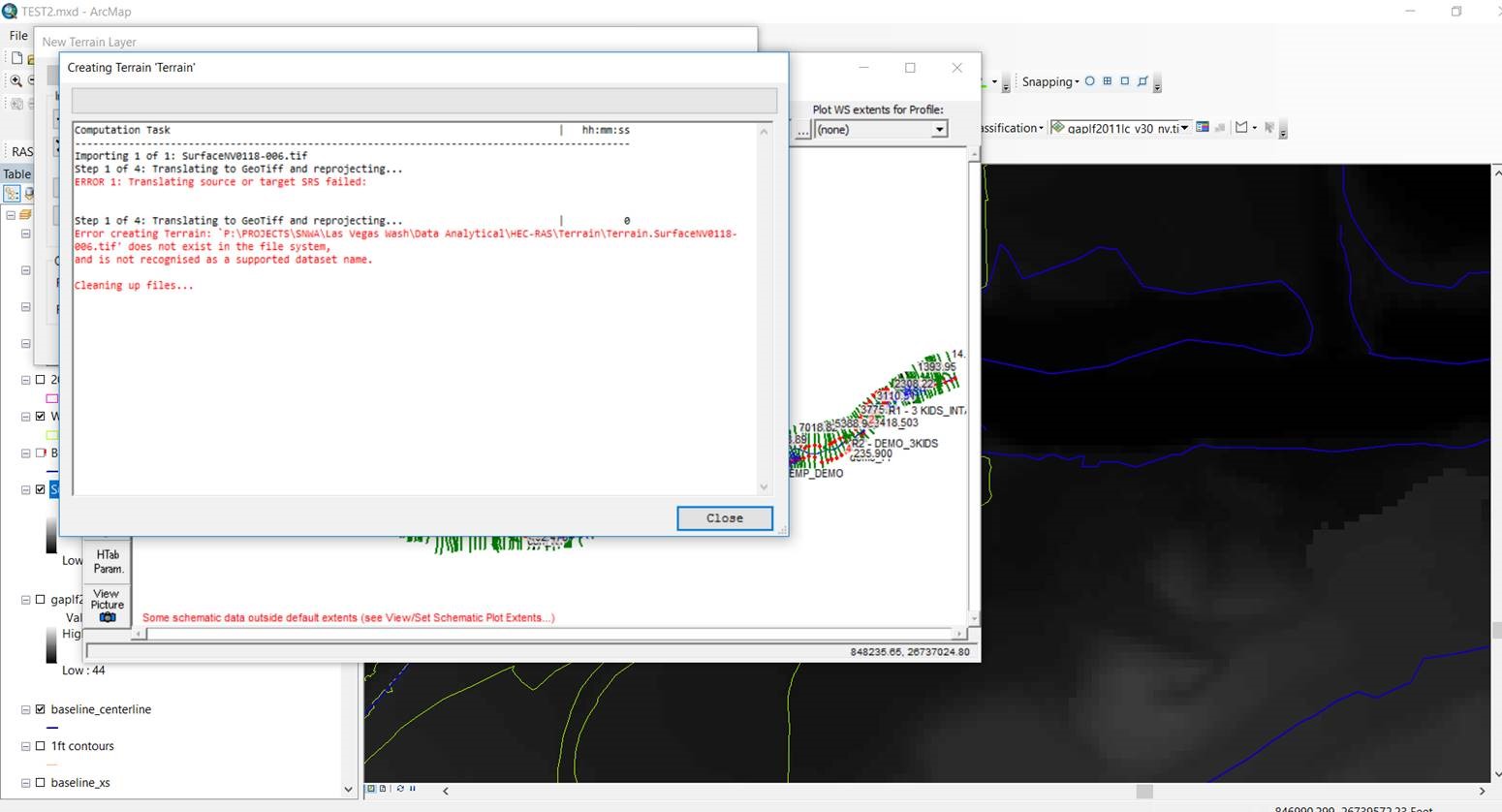

    I’m trying to create a new terrain but I’m getting the following message:
    Can anyone tell me what this means? I’m trying to import SurfaceNV0118-006.tif and save it as Terrain.hdf and doing it on the local drive. I’m not sure why it’s trying to create that long file name in the error message.
    Thanks
    #11333
    Mary
    Turns out that it was a problem with the *.tif. The projection didn’t get “attached” when I created it.
