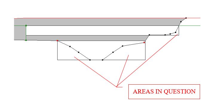

    Hello,
    I am wondering if the area referenced in the included image counts as flow area in my model. If so, is there a way to render culvert area outside of my bridge cross section as inactive? I do not want flow to be able to pass through these areas.
    Thank you for any advice/help!
