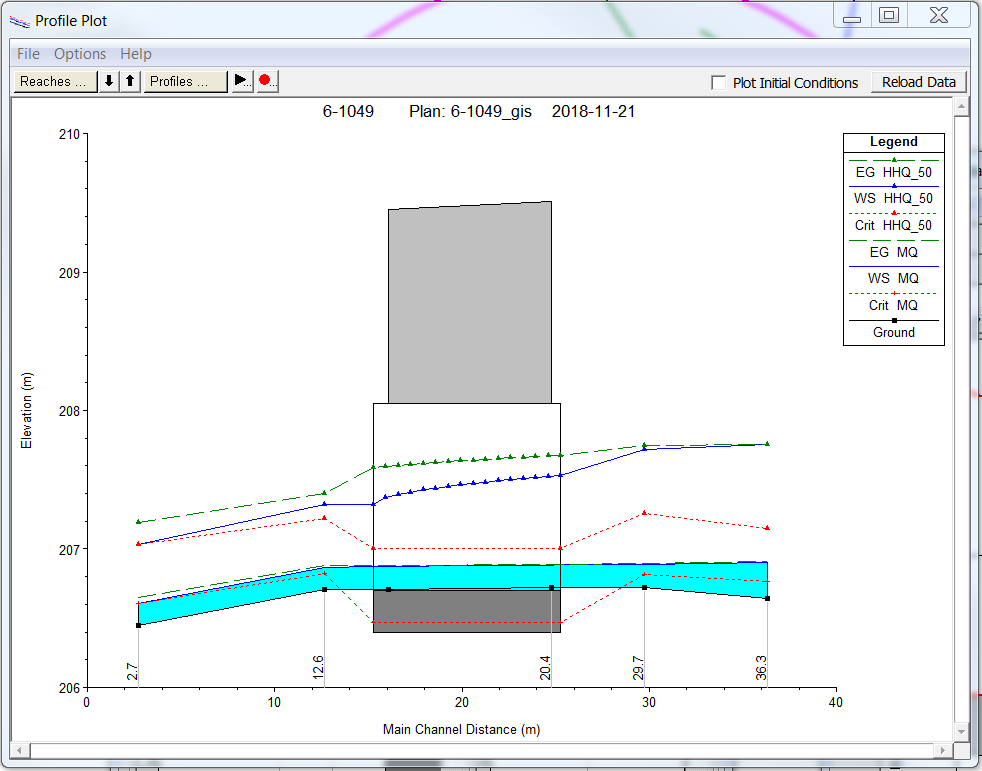

    I am modelling a culvert with very basic conditions.
    It is a 1D model 40 m long with 4 cross sections and a circular culvert.
    I have set up a blocked depth of 0.3 m in the culvert data editor, so I expected the critical depth to be above it, but in the profile plot is presented fat below the blocked area, see the picture.
    Is it correct?
    Why?
    Regards
