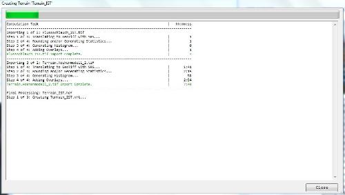

    I’m having trouble combining to tiff-files to a new terrain in the RAS-Mapper (HecRas 5.0.3). I have done several 2D simulations before and also combined terrains.
    However, now I have exported the interpolated XS-surface (from my river profiles) as a tiff file, and then – like usual – tried to create a new terrain using the newly created tiff and the original DTM.
    Projection & resolution are the same for both tiffs.
    Now, when creating the new terrain, importing the tiffs works fine, but the final step
    “Final Processing: Terrain_IST.hdf
    Step 1 of 3: Creating Terrain_IST.vrt…”
    just stops at around 1/5 and does not continue (I left it for like 14hrs, no result).

    Hy,
    check your folder name. Or name of your project, .tif file… I had the same problem, because my folder name contained letter “š”. When i change it to “s” it worked.
    #10140
    It works!!
