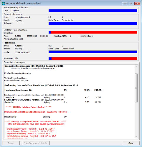

    Hello,I am trying to add a storage area for an unsteady flow simulation, when I connect the river and the storage area, the model error like this,
    can you help me please to solve the problem? Thank you.

    could be your time step is too high or could be lots of other things hard to say based on just that error.

    Thank you very much! I have solved the problem.That’s because of the elevation of the storage area.
