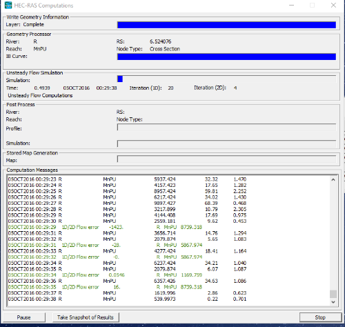

    All, Quick question…
    Can a 1D reach be connected upstream AND downstream to the SAME 2D area?
    For example, a 2D area that wraps around a 1D reach so that both its upstream cross section is connected to the 2D area and the downstream cross section cross section is connected to the 2D area.
    #12712
    With some testing at a small scale, i have discovered that this is true.
    A 2D area can NOT be connected to both the US and DS ends of the same reach. The software seems to be confused with the initial conditions. Hope this helps someone out in the future

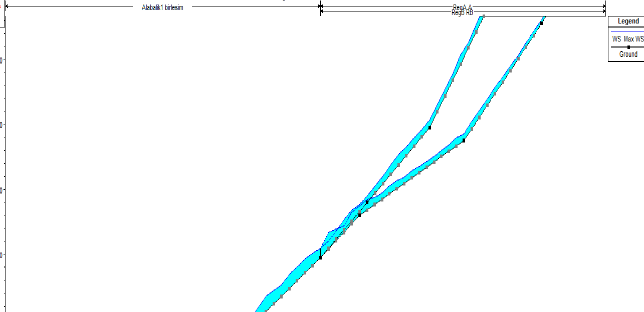

    You would have to have a gap between the two connections of at least 1 grid cell I believe. You would connect the upstream end of the channel to the 2D one way and then use lateral structures for each side.
    The figure below shows a crude example
