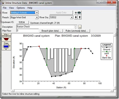

In modeling irrigation canals in HEC-RAS, a typical structure that is encountered is a check gate. Check gates are designed to back the water up behind them in an effort to keep the water level immediately upstream of these gates at a constant level. As the flow rates change in the canal, the gate openings on the check gates are adjusted (i.e. opened or closed) in order to pass the new flow rate while maintaining the water level upstream of the check at the desired elevation. Why go through this effort? Farmers usually get their water from these irrigation canals via orifices just upstream of the check gates. The flow through these orifices is dependent on the head (or the water surface elevation) acting on it. Since farmers want a constant flow rate delivered to their fields, the check gates in the main canal are adjusted when the flow changes to make sure the water level upstream of the check (and hence the rate of flow delivered to the farmers) remains constant.
Check gates can take a wide variety of forms, but typically they fall into two categories: undershot gates and overshot gates. Undershot gates are things like radial gates and sluice gates. As the name implies, water shoots “under” these gates. Inline weirs are typical examples of overshot gates. For these structures, water does not pass “under” the gate but instead flows over the top of the structure. Since many irrigation districts operate on limited budgets, it’s not uncommon to see an overshot gate made simply of several 2×4 wood boards that slide into groves in the canal walls. The irrigation canal operator “opens” these types of gates by manually removing one or more of the wood boards. In a similar manner, these gates are “closed” by adding one or more wood boards.
Modeling undershot gates has been straightforward in HEC-RAS for many years. You simply select whether you have a radial gate or a sluice gate and then enter the appropriate input data for the gate. The gate openings are then set through the flow editor-either steady state or unsteady state-depending on your situation.
Modeling overshot gates in HEC-RAS has been a little more challenging. Unlike the undershot gates, there really wasn’t a gate type that allowed water to flow over the top like a weir. Thus, you had to model overshot check gates using the geometry of the inline structure. An example is shown in the figure below. The four long white rectangles in the middle of the structure are undershot types of gates (in this particular case, they happened to be sluice gates). The two short white rectangles at the far right and the two at the far left (the ones with the open top) are overshot gates. Because in previous version of HEC-RAS, there wasn’t a particular “overshot” type of gate, you were stuck with coding these gates using the weir/embankment button. While this is perfectly fine for steady state mode where you only have one weir height setting, it becomes problematic if you run the model in unsteady mode and the weir height changes during the simulation. Because you have to model the weir as part of the geometry, there is no easy way to adjust the weir height as a function of time in unsteady mode.

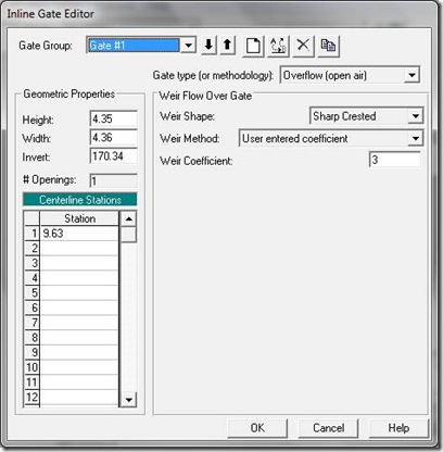

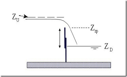

Starting with HEC-RAS version 4.0, there is a new type of gate called an “overflow gate.” As the name implies, this type of gate allows water to flow over the top of the gate as shown in the schematic below. There are two types of overflow gates in RAS: open air and closed top. Both of these gates allow water to flow over the top of the structure. The difference is that the closed top gate is kind of like an elevated orifice. At some water levels, water will flow over a closed top gate like a weir. At higher water levels, the closed top gate will function as an orifice.
clip_image002
For irrigation canals, open air overflow gates are exactly what we need to model overshot check structures. To use this option, enter the inline structure information exactly as before. Now, select “Overflow (open air)” as the gate type. There are three types of weir shape methods: Broad Crested, Sharp Crested, and Ogee. For modeling irrigation checks, using the Sharp Crested option is probably most appropriate. With this option, there are three ways to enter the discharge coefficient for the weir equation: User entered coefficient, Rehbock equation, or Kindsvarter-Carter equation.
clip_image004
The gate opening is still set through the flow editor (either steady state or unsteady state). For overflow gates, the gate opening is now from the top of the gate rather than the bottom. The figure below shows a check structure modeled with open air overflow gates. As can be seen, the gate opening on the far left is 1.56 feet. But this distance is measured from the top of the gate frame rather than the bottom. Now, if you are running this model in unsteady mode and the gate opening changes (that is, another weir board is added or removed), you can reflect this in the gate opening boundary condition.image

    Hi Chris, thanks for pointing out this option! One thing is not clear to my however: How can I control the gate's Crest Level (as opposed to the Gate Opening Height)? Is the only way to do this by implementing a closed top overflow gate and applying negative opening heights to it so as to keep the gates closed at all times and only allow for flowing over the gate's top? Or is there an option using an Open Air gate as well? As far as I can tell the Unsteady Data Editor only provides a possibility to enter a timeseries for the Gate Opening Height; not for the Gate Crest Level.
  21. Chris Goodell
    on October 26, 2016
    Siebe, with overflow gates, the gate opening value you enter in the unsteady boundary condition is measured from the maximum gate top elevation (gate fully up) to the actual gate top elevation. For example, you set the Height in the overflow gate geometry properties to 4 meters. And the gate invert elevation is 0 meters. If you put in a gate opening height of 1 meter in the unsteady flow boundary condition table, the gate will be open so that the crest of the gate is at elevation 3 meters.
  22. Siebe Bosch
    on October 27, 2016
    Thanks Chris! It's rather embarrassing how long it took me to understand the concept :"(. In The Netherlands we simple don't have any gates that move downwards in order to open up. All of our gates are opened by pulling them up, so it took a little mind bending to understand it.
